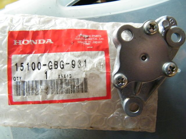

TRX90 Quad 8.8mm this is a 225% upgreade pump.
Honda part number is 15100-GBG-931

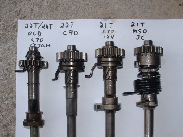

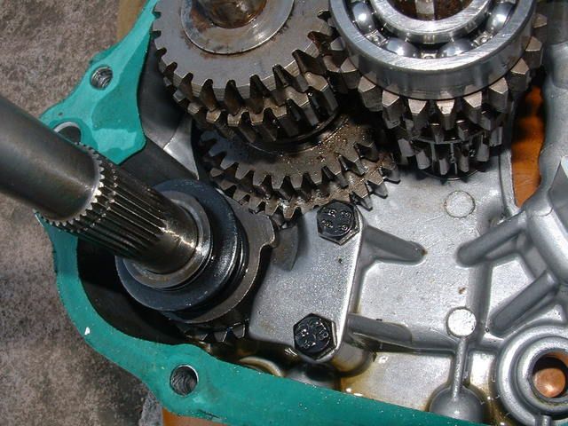

Kickstarts.
How the kickstart works/fits on most chinky engines. This is not found on Honda engines.
Here's some that I've collected.

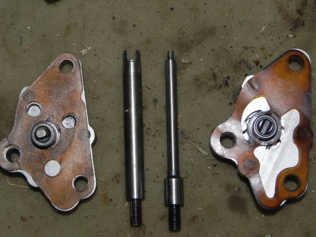

More on oil pumps.

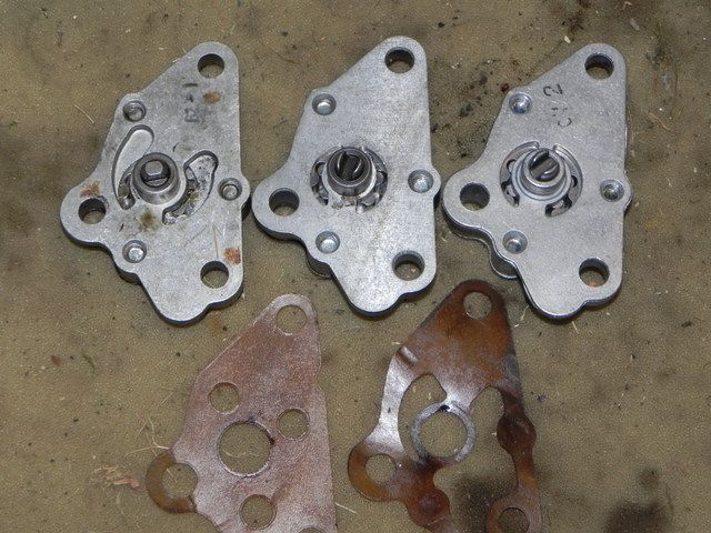

Left 6v with drive and right 12v with drive.

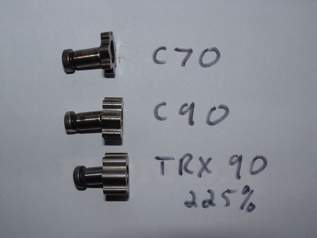

C70 C90 TRX90 note how the TRX90 one has more clearance around it for the bigger oil flow.

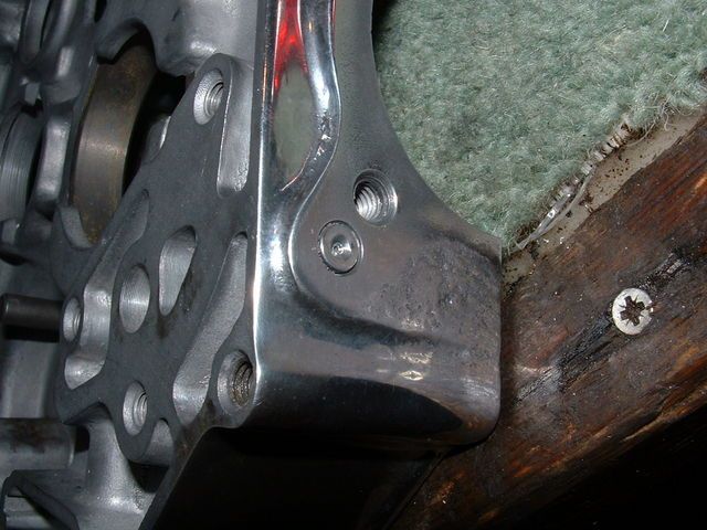

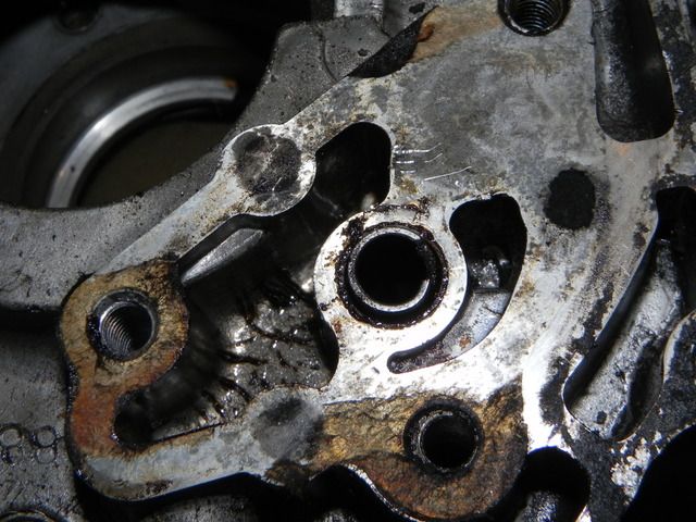

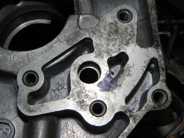

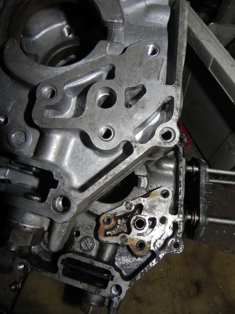

6v case on top of 12v case showing the difference between the oilways for the pumps.

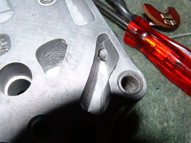

Black smug is the bit you have to grind out to make the 6v case fit the 12v oil pump.
To make it look like the 12v one.
As a side note you can get uprated 6v oilpumps somepeople fit them to bigbore monkeybikes,think they cost about £50+

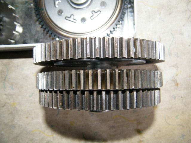

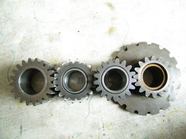

Most clutchs 6v or 12v manual and semi-auto are 17-69 or 18-67,but you can get others aswell 16-69 for the SS50 and a very rare one fitted to some S65's 20-65,have this one fitted in my C90 engined Dax with a ATC70 4 speed gearbox.
Small clutch gearwheels 20-18-17-16.
Large gearwheels.
69
67
65
All will fit the same manual clutch body Honda or chinky.
